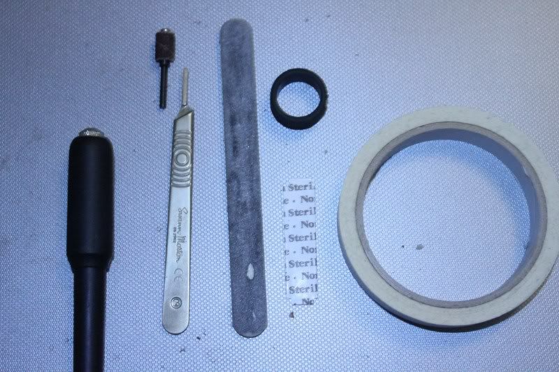

In this guide I will be using these tools:
Dremel
Cylinder sanding bit for Dremel
Masking tape
Ultra sharp knife blade
Knife
Sanding stick
So when you start your table should look like this:

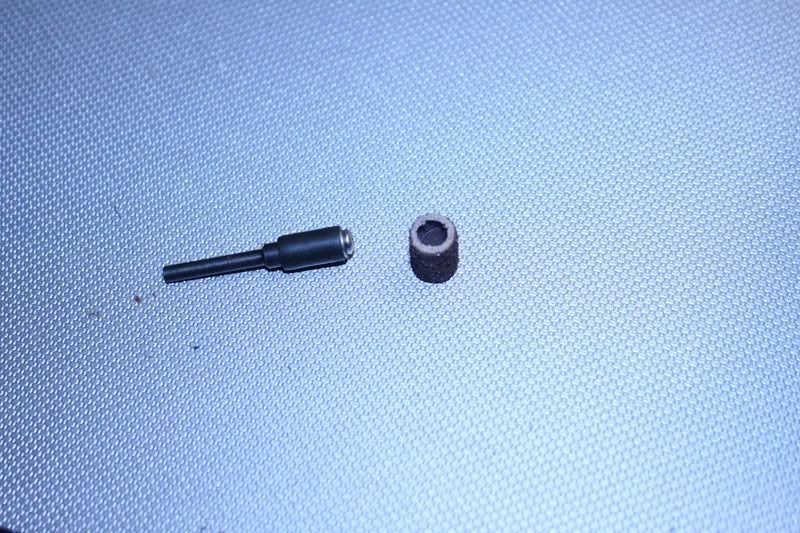

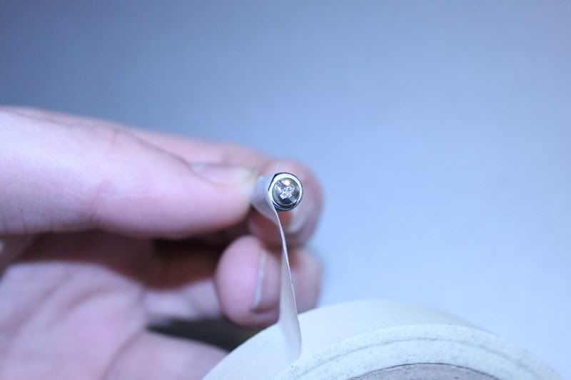

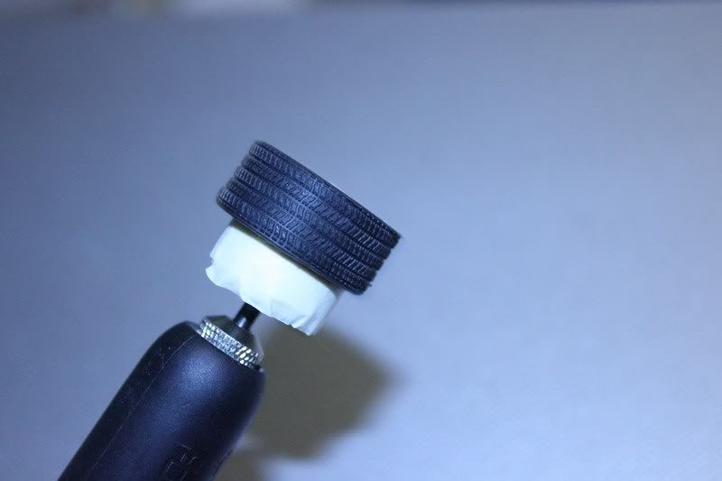

First of all, remove the sand paper from your sanding bit:

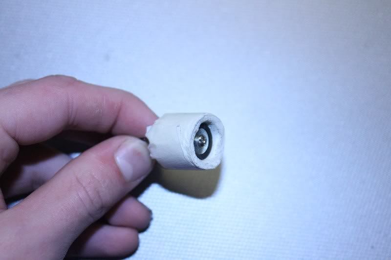

Wrap tape around it untill it fits your tire (Warning: This may consume a lot of tape)
So you end up with something similar to this:

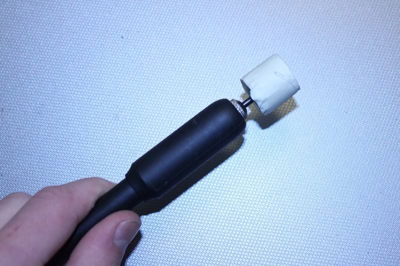

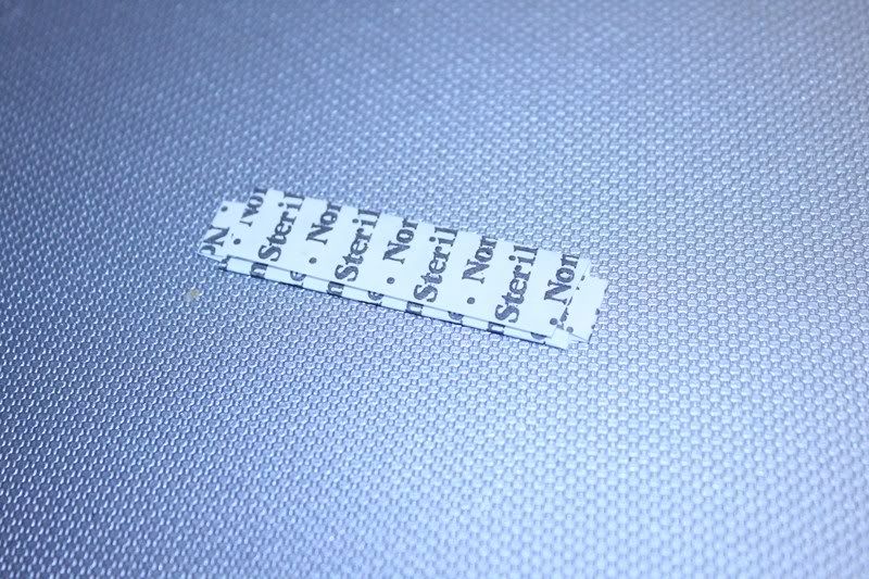

Now mount our Dremel Tire Bit on our dremel and save it for later:
Now take your ultra sharp blade (Warning: Ultra sharp blades are sharper than just sharp blades so be ultra careful)

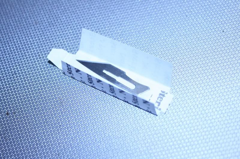

Unpack your ultra sharp blade:

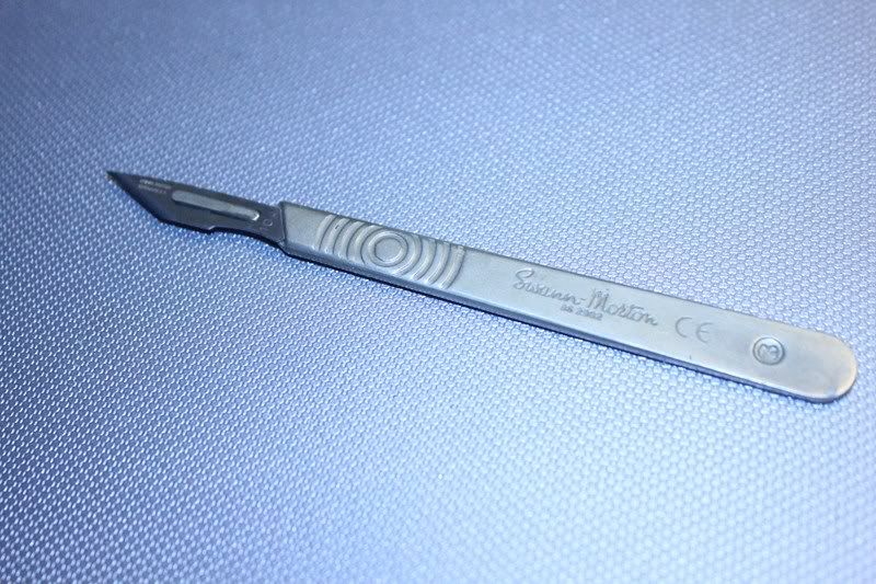

Carefully mount it on the knife

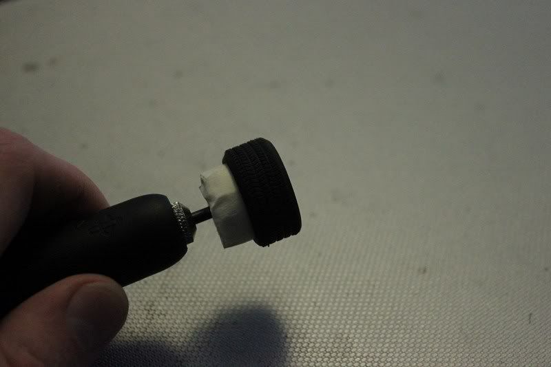

Now back to the Dremel. Mount the tire on our Tire Dremel Bit we made earlier:

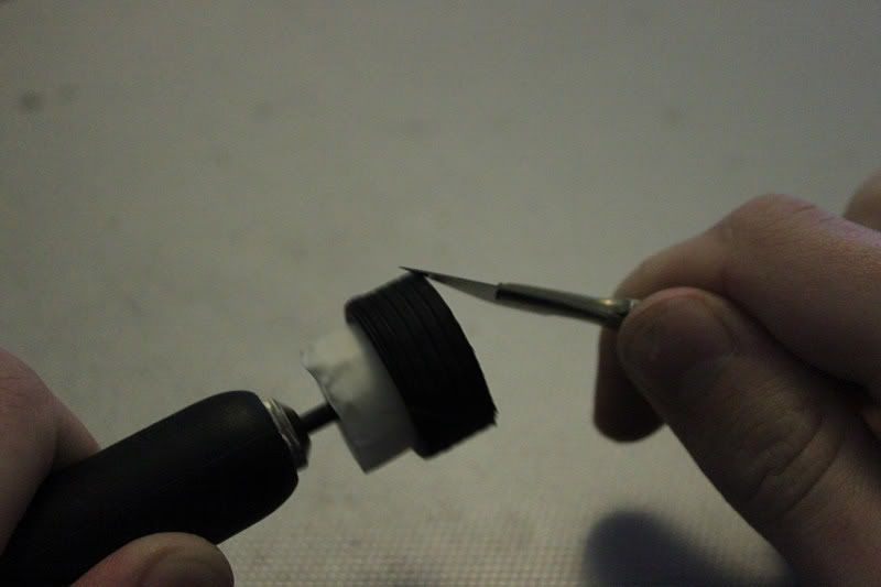

Start up the dremel and use your knife to cut off the side wall of the tire:

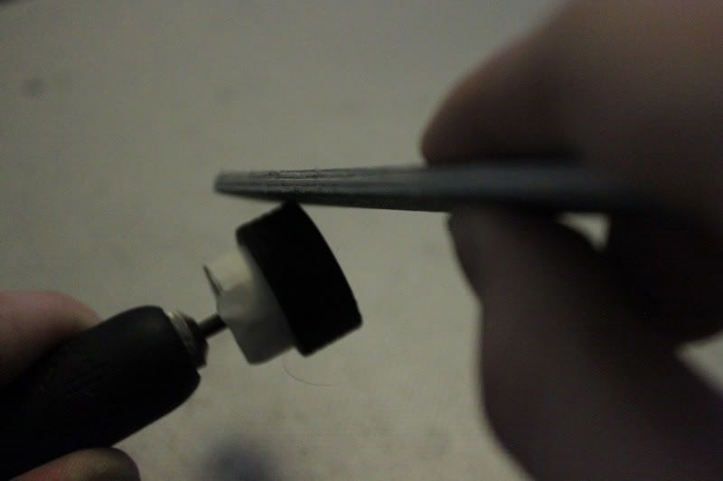

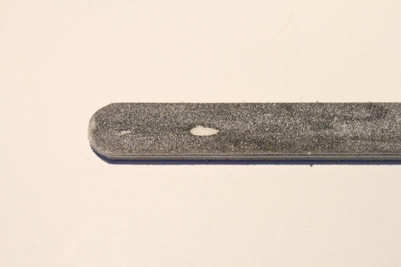

When you are happy with the angle, take your sanding stick and sand the cutted part so it become nice and smooth:
Remember to move your sanding stick around, otherwise you will get skid marks like these:

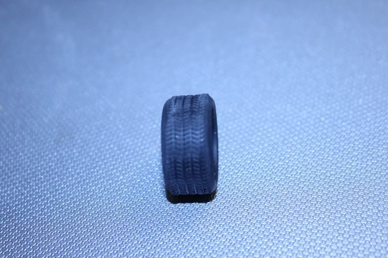

And there we go, one stretch wall tire:
Looks much nicer than what we started with:
